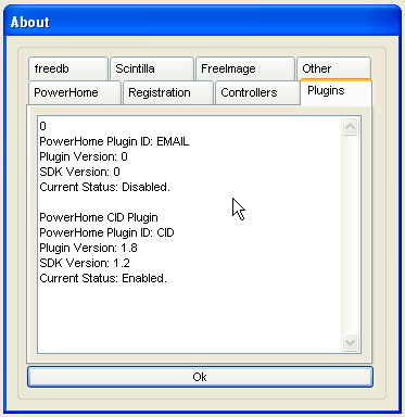

          Hi guys,
           | Posted: February 26 2008 at 22:52 | IP Logged |   |
 I tried to show my son how to use the email control in PH. Nothing happened. I checked things out as far as I could remember and it all seemed ok, I haven't done anything with it since I got it working solidly. I looked at the Help->about->plugins page, and it says the email plugin is disabled. How did this happen, and how do I re-enable it?

          From the screenshot in the first post, it appears that PowerHome wasnt able to load the plugin at all.  The very first line shows a 0 and the SDK version and plugin version are both 0.  With these values as they are, PowerHome has not been able to initialize or communicate with the plugin at all.

| dhoward wrote:
       | From the screenshot in the first post, it appears that PowerHome wasnt able to load the plugin at all. |  |  |
 and that info hasn't changed, still shows all zeros.

          OK everyone, here is the update on my email plugin not working:
           | Posted: March 04 2008 at 12:54 | IP Logged |   |
 Had Dave do a remote session with the computer last night, he spent about an hour going through everything. Turns out if you set the plugin time (to check email) to zero so you have to manually run it, the plugin loads. Manually entering a formula in the Multi-Editor has the formula result to a "2" which means it is having trouble logging into the email server through your MAPI client. Triple checked the password setting etc. and they were correct. Then we found that OE was no longer the default MAPI client.... it's the only email client on the machine... so we told it again it was the default, and re-tried. Results were still the same. The odd thing was though, if you used OE to check the mail itself, it got it! So it was a communication problem between PH and OE. After several different attempts by Dave punching in a variety of commands in PH, we decided to stop. Dave was going to do some testing on his end, and I was going to un-install then re-install OE just because of the fact it had decided on it's own not to be the default mail client.
 I have now done that... guess what... the email plugin loads, and is not only checking email but responding to the control emails as well!
