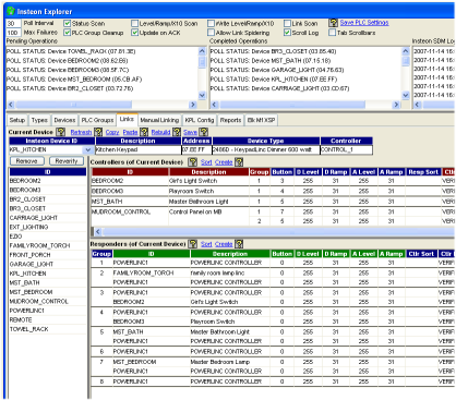

I have a button on a KPL the just acts as a status indicator for my garage door.
I created insteon group named "GARAGE DOOR" and set the group number to 140.
Then I linked the KPL button 8 as a responder to the PLC controller group 140.
I set a trigger to fire when the door opens. The trigger calls a macro that among other things turns Insteon Group "GARAGE DOOR" on which illuminates button 8 on my KPL. When the door closes, another macro turns the indicator off.

Here are screen shots of how I have set up my group and links for the KPL indicators
Group Link
These two files (trigger macrojust save these on you system) can be imported into PH to create the Macro and Trigger I use. Obviously they won't work on your system, but you can look at how they are put together. I am no where near expert on this stuff and I'm sure there is a better way to do it than the way I have.
To import them, go to the Maintenance menu and click Power Home MultiEditor. Make sure you are in SQL mode (should say in the Title Bar of the editor window). If not, click on the select box arrow next to the blue VB icon in the menu bar, select SQL. Next click the "Open Box" icon on the menu bar and navigate to where you saved the files and open one. You should now have the listing in the MultiEditor Window. Click the "Running Man" icon to execute the import. The results window will tell you if it was successful or not.
If you have any questions about them, just let me know.
