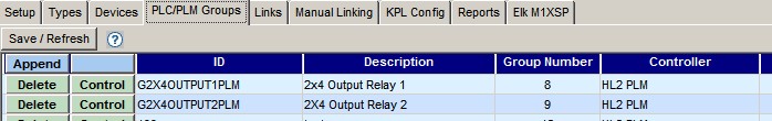

You use the PLC/PLM Groups tab to define an ID that represents the Group definition.

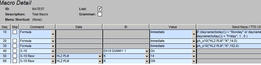

Here are three ways to code an X10 message sequence. Seq 20/30 is what we covered before. Seq 40 requires that you define an X10 device and give it an ID which is the ID used in the Macro line. Seq 50/60 may be easier because you can use words rather than command numbers. I picked seq 20/30 initially because I thought it would most closely match what you were already doing with the Stargate.

Thanks, Lee,
I'm sitting here plodding away. I can't find the screen you captured above - with the sequences. Where is that in ph?
Mark
| Posted: November 15 2009 at 23:51 | IP Logged
The image with seq 20,30,40,50,60 is a Macro I coded with 5 lines to show more X10 examples. I just cropped the image to include only the functional lines.
