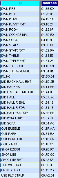

PLC = 08.A2.04
EZIO8T = 08.9E.0C
Light = 04.7D.0C

Interesting question! I have no devices with address F7.17.9F.
As to linking... since I have no F7.17.9F I'm not linked to it. The EZIO8T and the (PLC and two lights) are linked as shown in my screen capture several posts above.

Neither the F7.17.9F nor the A5.3c.18 addresses exist in my Universe!
That is what has been throwing me in debugging this. I assumed that maybe they were Command bytes (rather than addresses) that I just didn't understand.

Roger that. Here is my setup
BTW - the reason there are leading zeros in the data streams above posted is that these are from my Insteon Thermostat.
The STAT is defined as a device type but never used as such since it is subsequently defined as a Virtual Analog device and used in that mode for status and control. This seems to make things "unhappy" with regard to Insteon traffic, but I'm not sure what to do about it. Device 0E.60.36 is the STAT.
PS - thanks for the data stream labels. It was very informative for me.
What was interersting about them is that the final two Transmit (TX) messages were to the DWN TABLE light (01.63.E9 my test light) and were the PH Trigger response to the 10th data stream line up from the bottom of the post above
[RX RECEIVEINSTEONRAW=02 08 9E 0C 00 00 01 CF 13 00 GROUP OFF ]
This Command x13 out from the EZIO8T is to turn its linked lights off and is a Group Command followed by a Group Cleanup to 04.7D.0C (the linked shop light).
Yet these very same data stream elements do not seem to serve as Triggers in PH. At least I haven't been able to trigger on them, only a "Device Change" type trigger.
Dave, is this a issue that needs looking into?

FYI here is a list of my Addresses:
