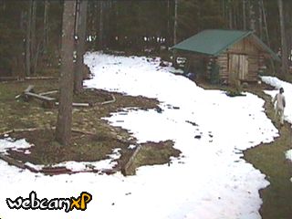

Lights come on. Ah hah I think. Must be a deer or bear outside. I look at the captured pics of the motion and at first don't see anything. Then I do. It is night so the IR illumination on the camera is on. It looks like a ghost is in front of the camera. Here is what I finally figured out. The propane heater had just come on. The exhaust vent for the heater is about 30 feet away from the camera that sensed the motion. The steam from the exhaust was creating clouds which the camera picked up as motion. In the winter months, going to happen a lot. The heater usually only stays on for a few mins and then turns off.

P.S. Here are a couple of pics with the steam cloud that triggered the motion.
And here is the same view but during the day. It had picked up the motion of me walking.
