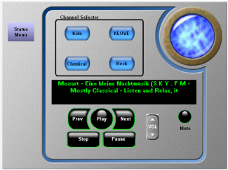

I was wondering if there is some way to duplicate tabs in the control center.
Dave's new way of creating sliders in version .12 works well and scales up well. I have 19 sliders on the CC screen and it takes a while to create all the graphics and line them up. I would like to create a similar, yet slightly different, screen for a different monitor in a different room.
Any ideas?
Here's a screen shot.

Looking good!
I thought one of the new features was better copy/paste for just this type of thing.

Heh, duplicating a CC tab is easy. From the PowerHome Explorer, just navigate to the Control Center Tabs screen. This is the screen showing all of the tab ID's (as opposed to the detail for a single tab). Right-click the line of the tab you'd like to duplicate and select "Duplicate" . This will give you a complete copy of the tab including the tab objects.
The latest version does include some new copy/paste functionality...but only within the current tab. This functionality is available on the toolbar or the menu. Basically, just highlight multiple objects (the drag rectangle works great for this in case you have objects stacked). With the objects to copy selected, just press the "Copy" icon on the toolbar. You'll get a complete copy of all selected objects stacked on top of their parents (the screen will appear unchanged). The previously selected parents will be unselected and the copies will instead be selected. You can now use the arrow keys to start moving the selected objects or right-click to instantly transport the selected objects to the right-click location.
The next version will include the ability to copy and paste selected objects from the current tab to a completely different tab.

Thanks Tony and Dave,
I had tried copying from one tab to another, but not the entire tab as Dave suggests. I'm going to do that now.
nadler Super User
Joined: February 25 2006 Location: United States
Online Status: Offline Posts: 354
Posted: October 10 2007 at 16:24 | IP Logged
Tried it. Works great!
