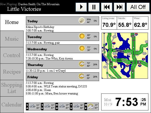

Peter, it works great. I have a daily job that the dumps out the next ten days of schedules every night at midnight. This is integrated into my HA display and since my phone syncs via a bluetooth as soon as I walk in the house - well, it's always mostly current.
I recently posted the executable to another thread - you can find it here: Calendar Software: http://www.myx10.com/forum/forum_posts.asp?TID=1503&KW=onhia tus
I've added a few minor format keys since then, but it should give you a good idea of what I've got and how to use it.
Let me know if it helps you out! Someday I plan on rewritting as a PH plugin, but don't see it happening anytime soon...
Older version of my home screen showing calendar integration:
Additional images can be found in previous post here
