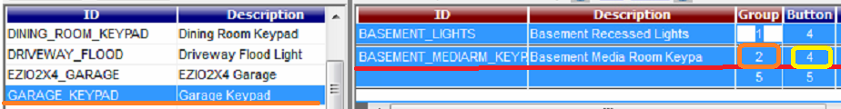

3 - Buttons and Groups when linking still kind of confuse
me. I put Insteon in my entire house when I bought it in
2006 and have 450+ links, I should know by now. In the
attached screenshot, looking at the garage_keypad, the
2nd link. The group 2 in orange refers to the 2nd button
in the MediaRM keypad and Button 4 in yellow refers to
the 4th button in the garage_keypad. The first link is
part of the same "scene" so, the group 1, refers to the
basement light switch and button 4 refers to the same
button 4 on the garage_keypad... This is the way I have
always interpreted it. Is their any easier way to think
about this? It's rare I make any changes so when I do, I
have to stop and wake my brain up again.
Sorry, Chrome didn't upload the image... IE worked.
Thanks again guys!
