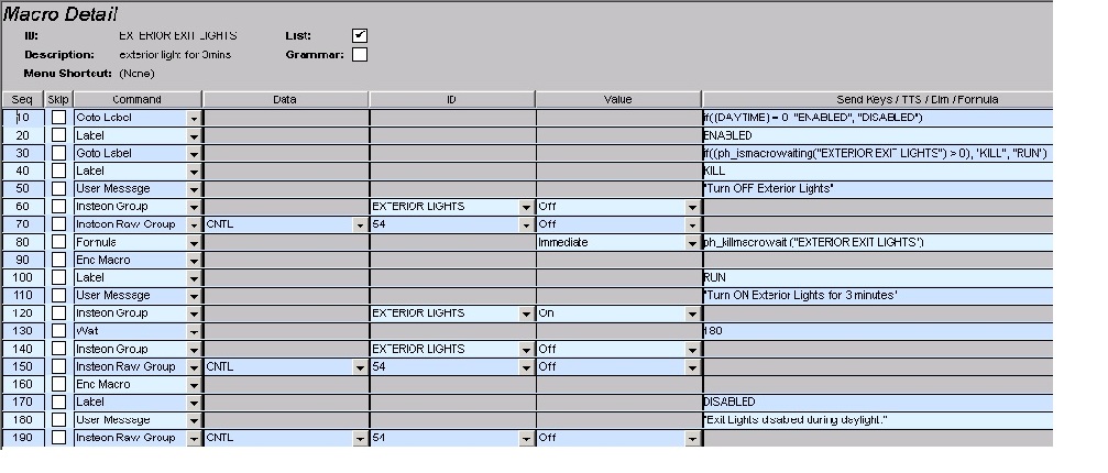

Here is exactly what I am doing:
Posted: February 07 2011 at 19:44 | IP Logged
The developer subscription should give access to the restricted section of the web site where the latest information is contained.
I ran a ph_insteonrawgroup and ph_insteongroup test for the same PLC/PLM Group on 2.1b. PH is issuing the expected commands on a PLM.
Do you have a trace of the macro when it works versus a trace when it fails

Posted: February 13 2011 at 19:47 | IP Logged
There is a potential timing issue. An inbound Group Broadcast for Group 5 On from 06.7E.12 looks like it triggers a Macro. An outbound Group Broadcast for Group 0x37 On is sent. The problem is the device 06.7E.12 that sent the Group Broadcast is not done with Group processing. There is a Group Cleanup inbound for Group 5 On from 06.7E.12. The effect is to have two Group sequences running at the same time. Insteon will abort one in favor of the other. Don’t know if this is part of the problem.
From the rest of the sequence I would have thought the trace labeled as a failure is actually the working case but putting that aside for now. The working trace has an outbound Group Broadcast for Group 0x37 Off. This is followed by an outbound Group Broadcast for Group 0x36 Off.
In the trace labeled not working there are three outbound Group messages
First is Group Broadcast for Group 0x32 Off - this does not appear in working case
Second is Group Broadcast for Group 0x37 Off
Third is Group Broadcast for Group 36 Off
The overlap of the two Group sequences at the beginning is generally not a good idea. Rather than triggering on a Group Broadcast, trigger on the Group Cleanup.
There are no Group Cleanup messages for Group 0x32, 0x37, 0x36. A Group Broadcast is much like an X10 message. It goes on the powerline in the blind, not sent to any specific device and NOT ACKed so it cannot be retried. Group Cleanup messages are retried if not ACKed.
The cause of the missing Group Broadcast for Group 0x32 in the working case cannot be determined from the Insteon Raw Log.

Lee,
Thanks for looking at the logs.
I will change the macro to one group broadcast but I don't see how to change the trigger to Group cleanup.
Patrick
Posted: February 14 2011 at 21:21 | IP Logged
The Insteon Direct/Group Cleanup trigger option did not work for me and there is no way to specify a Group number so it could not be used with a KPL button even if it did work. If that is conflicting with the Group that is being initialed as a result of the KPL button press a Wait can be used to create a delay long enough for the Group Cleanup to come in from the KPL button.
