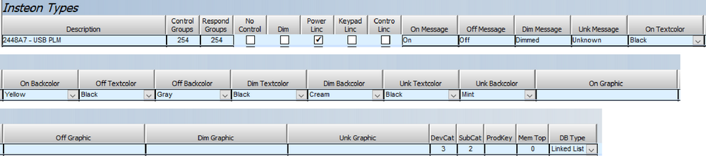

QuickCarl2K1-
I suggest starting all over again for your device type configuration for the 2448A7
Go to the PH Explorer>Types and select the 2414U - PowerLinc Controller USB Device in the Description column. Then right-click on that device's description and select the "Duplicate" item from the pop-up menu.
That will create a copy of the 2414U and put it at the bottom of the Devices list.
Scroll down and find that new entry and make sure the entry fields look like this...
Your pwrhome.ini fill should have this (yellow highlight) for the PLM entry...
Update your Insteon Explorer Devices Tab entry to use the 2448A7 entry for your PLM device and hit Save/Refresh to cause this entry to be saved into the PH database.
Restart PH and I believe things should work for you.

Did all as you suggest. Still getting the same firmware version error (3A)
I am using PH version 21b, could that be the issue?
