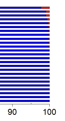

Oh, that doesn't sound like fun to troubleshoot. I don't think it's caused me any problems yet.
And it doesn't look like I've had a lot of NAKs. The top device is the one I just installed, so it
has only had about ten uses. Since the graph shows percentages, just one or two NAKs will look a
lot worse. Of course, the way you describe this problem, it's really not a problem with a single
device, but rather a problem with the system and network overall.
By the way, is this chart (it's the ack vs nak chart from PH) showing NAKs for each device when it
was the sender or responder? In other words, say I have two linked devices, a controller and a
responder. If the controller sends an ON signal to the responder, but the comms break down here,
does PH record that as a NAK for the controller or the responder in this case? This is an
interesting question (to me anyway) because some devices can only act as a controller (a
controlinc, for instance) and some devices can only act as a responder (a lamplinc for instance).
Would it make a difference with regards to troubleshooting? If I had a device that was excessively
higher than the rest with NAKs, might I look for different things if I knew it was having trouble
sending vs receiving?

I was thinking there were more than a few NAKs when I read "I noticed some red eventraw=05 log messages roll by". An ACK is sent by the device receiving a command, back to the device that sent the command. Device A sends a command to device B. Device B sends an ACK back to device A to acknowledge receipt of the command. Should device A not receive the ACK it will retry the command sent to device B. With the way the Insteon powerline works the PH2 PLM generally does not "see" the ACK that device B sends back to device A. It is on the powerline at the PLM but the architecture is such that the PLM does not pass out to PH2 Insteon commands/ACKs that were not addressed to the PLM. The net of that is the NAKs to ACKs are for commands the PLM sent to specific devices. That chart actually looks good.
