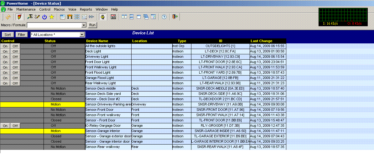

Goals:
1. Perform exterior Automation lighting with PH
2. Perform slightly more "macro" lighting based on time of day and event (i.e. after 11:30, turn on all exterior lights for any 1 motion sensor trip.)
3. Control Garage door sensing & control via PH and M1 keypad
4. See alerts from Motion events on Elk panel
Screen shots attached. Help and comments appreciated.

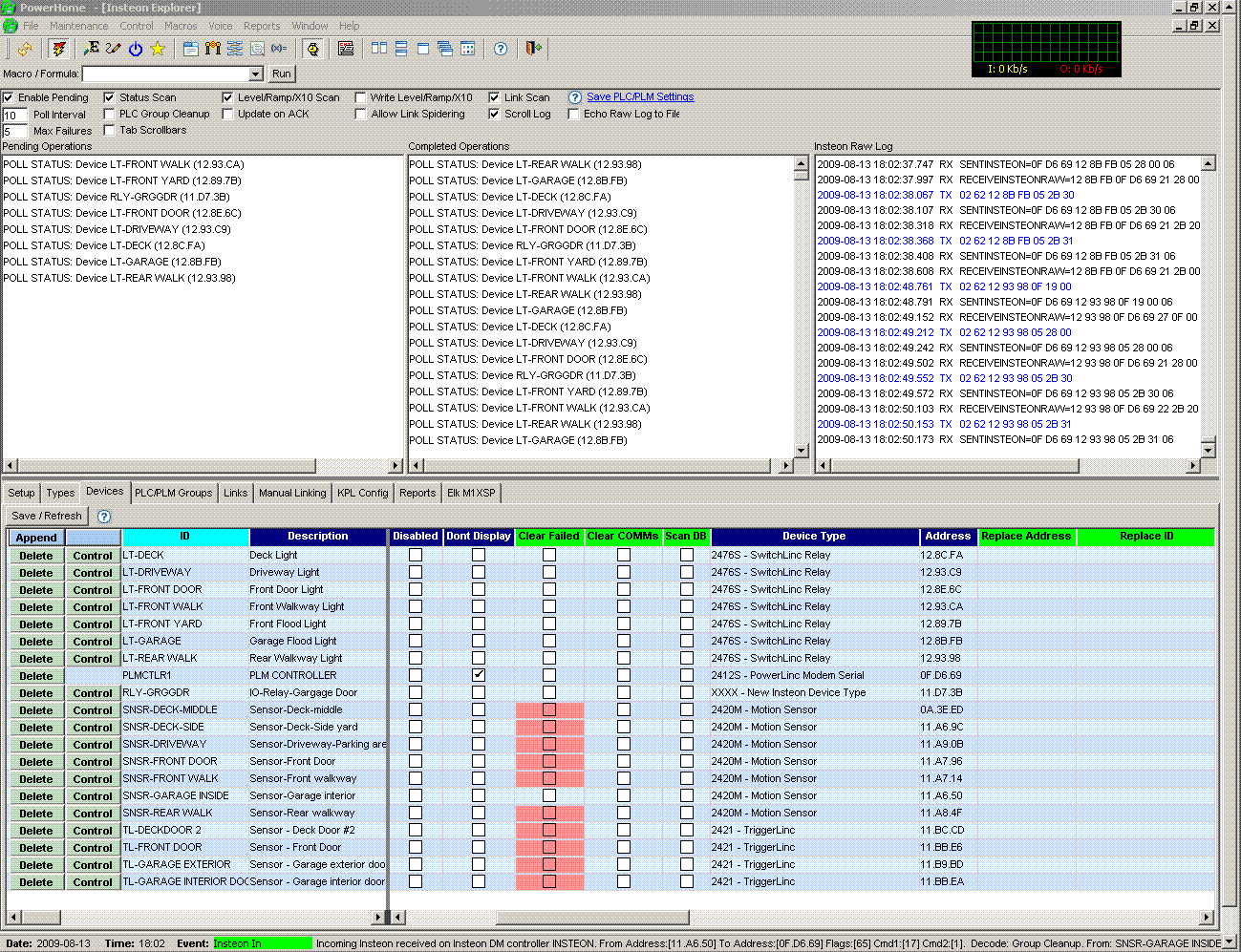

Posted: August 13 2009 at 22:27 | IP Logged
Lots of great data but no specific question. The red shaded Motion Sensor entries are the result of not being able to communicate with the motion sensor. For battery operated devices, they must be in link mode before they will communicate to extend battery life. In the case of the motion sensors they do not support Peek/Poke commands so they cannot have the link database read or written even if in link mode. The TriggerLinc is also a battery device so the red shaded column may be because they were not put into link mode before PH tried to communicate with them. I do not know if a TriggerLinc supports Peek/Poke.
Since this may have nothing to do with your question, suggest you post your specific query.
Also you did not mention Access Points which are needed to receive signals from the motion sensors and the TriggerLincs.

Welcome to Powerhome. I’m with Lee. If I read the supplied information correctly you are concerned with the fact you are not communicating with the devices. As Lee stated you must put the devices in link mode to get PH to be able to establish links otherwise the shaded areas. Don’t forget to check Cleared Fail to reset them.

Ahh, the Access Points. I have 2, and they are associated with outlets on the left and right side of my breaker box. All motion sensors are within range. No powerstrips or UPS's in use.
I thought I could join the devices just by manually adding the addresses. I'll hit the set button on each, get them linked, and report back on next challenge.

So it does not get lost in the question about waking a battery device, PowerHome cannot read/write link records in a Motion Sensor. You can link the PLM as a responder to the motion sensor by putting the motion sensor into link mode and then perform a "Manual Linking" operation which causes a responder link message to be sent from the PLM. This completes the link process with a motion sensor. It has the same effect as manually linking an Insteon responder device.
As I mentioned before, I do not know if a TriggerLinc supports Peek/Poke. If it does then PowerHome will be able to read/write link records to that device type after you have made it awake. If it does not then it will have to be treated the same as a motion sensor as far as "Manual Linking" is concerned.

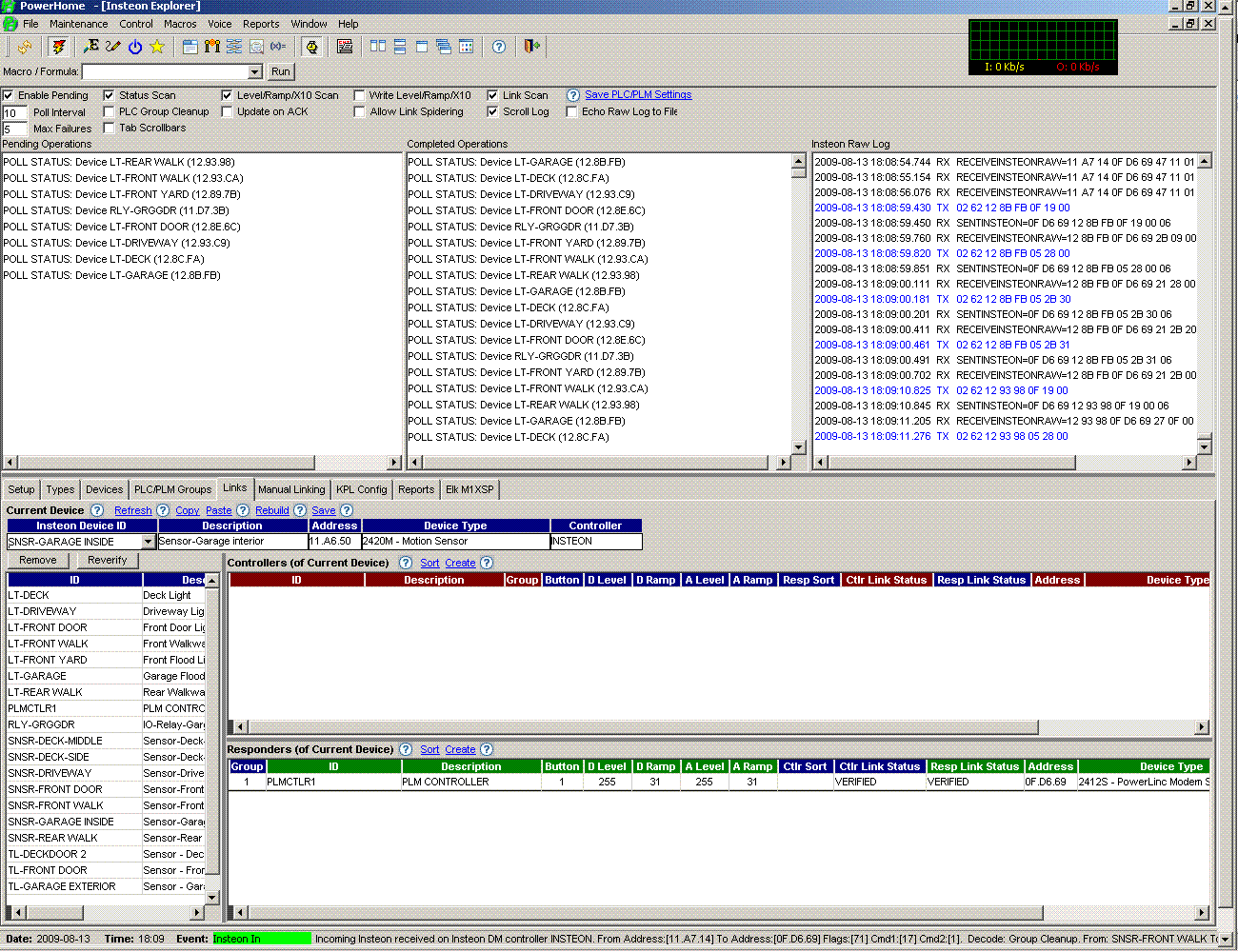

I've tried the wizard and the manual link tab in Insteon explorer to add the "Sensor Garage Interior", and I can't see any difference in the configuration or the behavior of the devices. I've been seeing activity from each of the sensors already (see screen below), so I'm not sure what the problem is at this point. If PH see's the motion detectors going ON, why can't I create rules/macro's at this point?

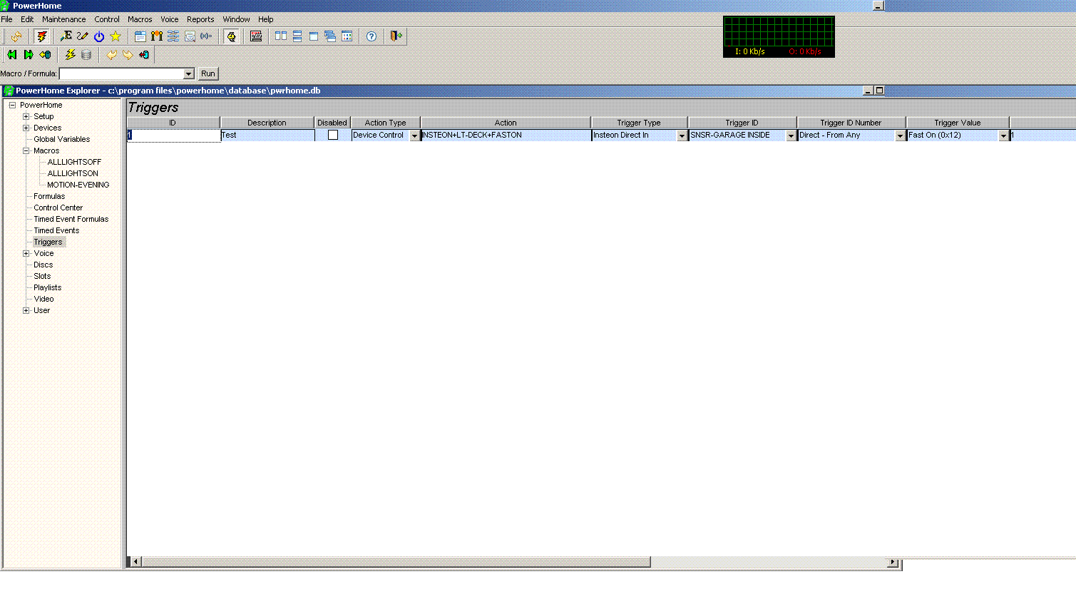

The following link will get you to a trigger definition for a motion sensor.
Link To Motion Sensor Trigger Definition
I would suggest the trigger action be the invocation of a Macro and issue the Insteon commands you want to happen from the Macro. There are potential problems with issuing Insteon commands directly from a Trigger that do not exist when issued from a Macro that is started from a Trigger.

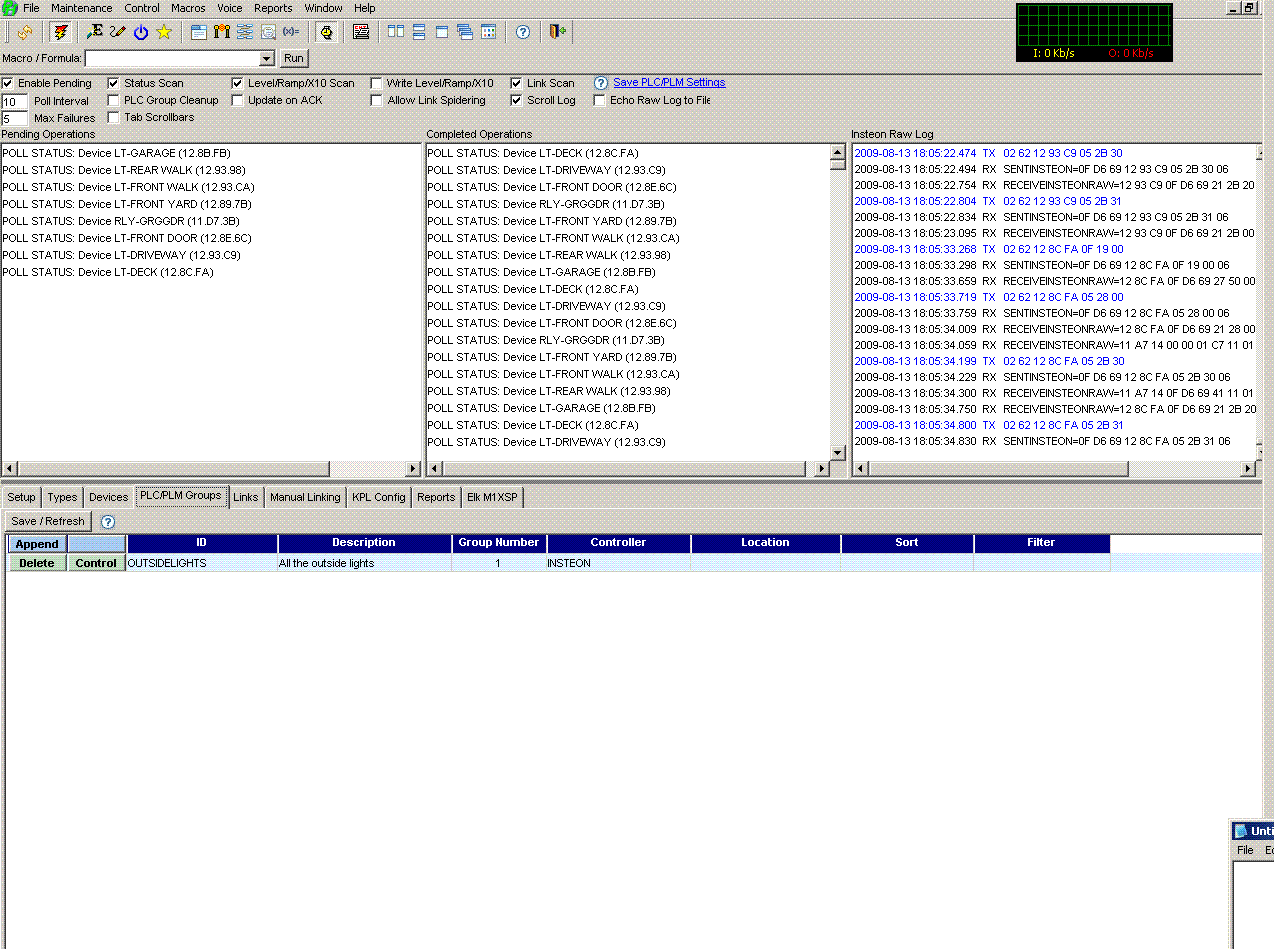

If you click on Control/Powerhome Status, you will get a display which has an Event Log toward the bottom of the display. If you trigger one of the motion sensors that has been linked correctly, you will see the Group commands the motion sensor is issuing for a motion detection. This information can be useful in defining a Trigger for an Insteon device you may not be familiar with regarding the type of Insteon commands being issued and the command codes involved. The only potential gotcha is that the Event Log is showing the cmd1 values in decimal (17 for an ON command) and the trigger value is showing the command value in hex (0x11 for ON command).

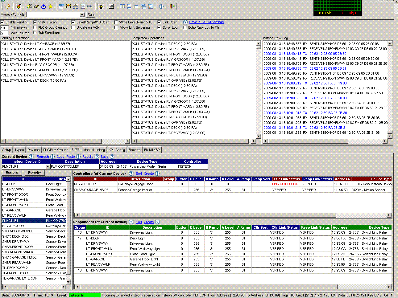

John unless I’m missing something I don’t think the devices are linked to the PLM. You have to put the device in linking mode by pressing the setup button then you have 4 minutes to go to the PLM and press it’s setup button until the other device stops blinking.
Posted: August 14 2009 at 13:36 | IP Logged
Pete, I think he did a successful "Manual Linking" tab operation because the Device Status screen capture shows the motion sensor ON. I could be wrong but I don't think it would show ON unless the PLM has taken the motion Group 1 message and passed it on to PowerHome. The only trigger definition that is posted as a screen capture specifies a Fast On command as the trigger value and that does not work because the motion sensor does not issue a Fast On.
Posted: August 14 2009 at 13:53 | IP Logged
Lee, I think they are linked and the trigger is set wrong but just to make sure I was looking for clarification. When I originally fought this problem it seems the device status screen showed motion detector on but the trigger won’t fire. Turned out it was partially linked cause I defined the links rather than let the device and PLM work it out. Sometimes the motion detector during setup has a mind of its own.

Manually added PLM to the motion sensor (twice) the the motion sensor activity is not being registered in Device Status. The set button will light up the Status screen, but motion is a bust. Feels like a step backwards.

Although I think using the “Manaul Linking” tab is easier, using the SET button on the responder should work and that technique is all hardware. No PowerHome involved. If pressing the Set button on the motion sensor does not show up in the Event Log or the Insteon Raw Log windows, hardware did not create the link.
If you do decide to come back to Powerhome, I would use the “Manual Linking” tab to create the link between the motion sensor and the PowerHome PLM. Then correct the errors in the trigger definition, using the information in the other post, set the trigger to invoke a macro and issue the Insteon commands you want executed on a motion detection in the macro.

John, going back to your earlier post, if your trigger is still the same try this. Trigger Type - Insteon Group In, Trigger ID Number – 1, Trigger Value – On(0x11).
