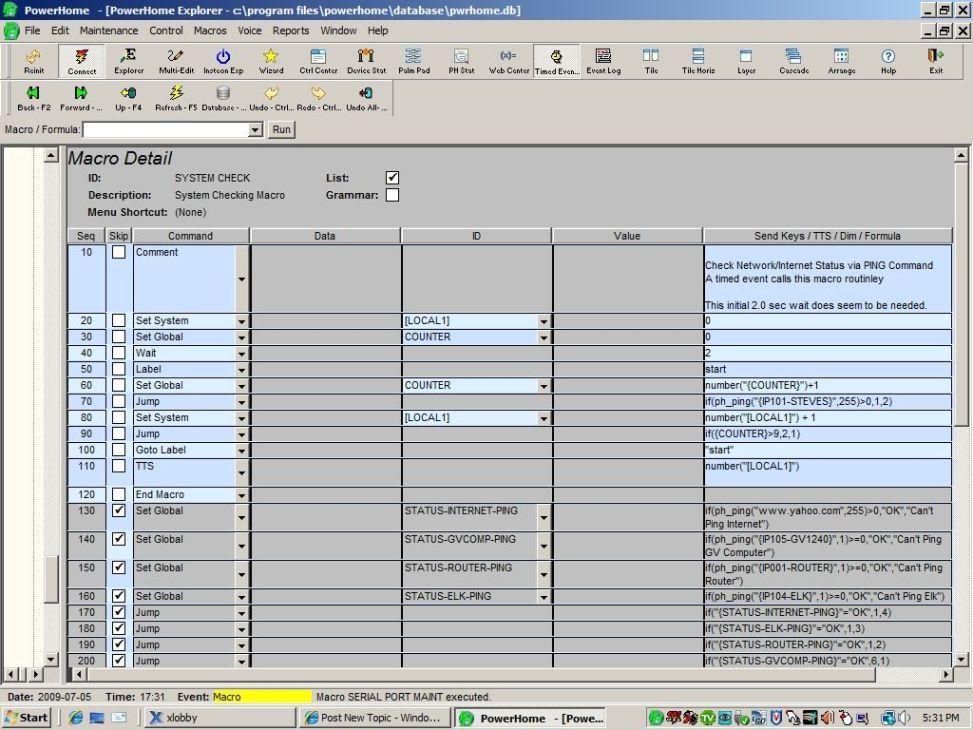

I am trying to develop a macro that checks for network connectivity amongst the different IP address's I feed to PowerHome.  If network problems are found, I will toggle the Insteon Appliancelinc that power both my modem, switch  and router (...I have found that 98% of the time this seems to clear up any network isues).
 Presently I use the "ph_ping" command.  If the ph_ping command returns a posative value, the computer is connected to the network, while if any negative number is returned is an indication of loss of connectivity.
 QUESTION: Is the above interpretation appropriate for what I am trying to accomplish?
 If it is a valid means for what I am trying to accomplish, that would lead to my next question.  Why is it that when I use ph_ping command, that a fair percentatge of the time the ph_ping fails, when I know there is proper connectivity?
 See the picture.  Here I attempt to ping
 ph_ping("{IP101-STEVES}",255)
 the above line 10 times.  I then TTS the number of times the ping saw connectivity.
 Most of the time this is usually 2/10 or 3/10.  Only when I ping the router directly do I see 10/10 like I would expect with all the others (assuming good connectivity).
 Anyone have any better way to routinely monitor home network connectivity?

Maybe I am missing something here but why are you pinging an established connection on a LAN and the dynamic ones on the Internet?  When you toggle the router and modem you are reestablishing DHCP addresses. The ones that are defined in PH I hard code the tcpip addresses in so they don’t change and are not affected by a bounce of the hardware. I would think bouncing the hardware to fix a connectivity problem only circumvents an underling problem thus that most likely will reoccur. To answer your question I believe you are testing for connectivity correctly but lost pings can be the result of different problems. For the sake of connectivity anything out of 10 is connected 10 out of 10 failed is loss connectivity. To answer the 2nd question, what does a ping from the console to the failing IP show?

I have a macro that does this and I use 2 failed pings's to indicate a problem. I use Google and Yahoo.
       jump | if( ph_ping( "google.com", 128) < 0, 1, 999)
 jump | if( ph_ping( "yahoo.com", 128) < 0, 1, 999)
 TTS | "Internet connection down! Resetting D S L modem."
 Macro | DSL OFF
 Create Timed Event | DSL ON | ph_relativedatetime( today(), 1) |

 I am trying to test for connectivity to my fixed DCHP addresses (which is a router check of sorts) AND to the dynamic internet address yahoo, which is sort of a modem/internet connectivity check.
BeachBum wrote:
       | When you toggle the router and modem you are reestablishing DHCP addresses. |
 My internal network addresses are static.
BeachBum wrote:
       | To answer your question I believe you are testing for connectivity correctly but lost pings can be the result of different problems. For the sake of connectivity anything out of 10 is connected 10 out of 10 failed is loss connectivity. |
 OK, I need to change my success threshold to be "anything above 0 out of 10".
BeachBum wrote:
       | To answer the 2nd question, what does a ping from the console to the failing IP show? |
 This is the weird part.  Regular DOS based pings always return good; no packet loss, and very fast.  The question is, why do the ph_pings seem to fail a lot (or at least most of the time), while the DOS pings ALWAYS show connectivity?

I thought that was where you were going with the 2nd question. DOS pings work at command level. I would guess there is an inherent delay coming from PH. Only Dave may be able to answer that one. If you want to tighten your threshold a lot of folks adhere to 5/5 failure rate. Sooo back to the other scenario why does bouncing the router, modem fix your problem 98% of the time?  My question; why do you have a switch and a router?
