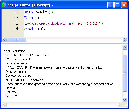

After a day of debugging and going crazy as I couldn't discover any reasons for the failure of a small vbScript to execute, I finally pared it all down to the following simple single line of code that fails.
I have found no way to make this "acceptable" to Windows Script Host.
I have entered this in the PH Multi-Edit VB Script Editor window, and received the above noted error comments when trying to test execute this in the editor window.
In actual practice the Macro that calls this script produces no results (in practice x is written to a Global Variable in the next line of the script using ph.setglobal_n. That write operation works OK. It is only the 'ph.getglobal_n" that fails.

I've caused PH to behave similarly after doing something that's caused it to get into a bad state. A quit-then-restart of pwrhome.exe has always fixed it. I'll throw it out there in case it helps your situation, b/c I don't see anything wrong w/ your code.

In the strong belief that these Forums are highly useful and educational, coupled with the realization that it is easy to ask questions, but often overlooked to provide the answers when an issue is solved, I pass on what was discoved about this issue.
Dave VNC'd into my system last night in an effort to discover the bazarre reasons behind this failure, as the written code is correct, but efforts to execute it none-the-less failed.
It turned out that somehow my "phscr.pbd" file (located in the pwrhome root directory and which controls PH<>WSH interactions) got corrupted, thus no "ph.xxx" commands would work.
Replacing that single file cured the problem. (Had to do a clean install to replace the file, but on my 2nd computer which is sync'd to the PH machine for editing purposes, I only had to replace just this one file.)
I would not have found this in a million years without Dave's help.
Thanks Dave and KUDO's for such world class user support. (Probably the best user support I have ever experienced and I have been a computer programmer/user ever since memory was acoustic waves in a pool of mercury and a fast machine was one instruction per millisecond!)
