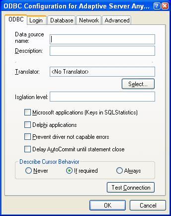

I seem to have the same problem. Attached is an image of the error I get after a reboot, using Autologin/PH startup. If I cancel out, and then start powerhome from the start button - I work OK, and PH is fine.

Thanks for the advice. The utility is PHUPG.exe, a nice utility, which I ran (after I made 2 backups ). This did not fix my problem. My curiosity is that when I start PH intially it fails, but then starts OK after hitting cancel.
Since I start PH using AutoLogin and PH is in startup, I troubleshot by eliminating moving parts. If I reboot, and auto login, but start PH via the icon, not startup, it would sometimes fail. There it is...timing! Consistently if I wait about 20 seconds, for everything else to start, it worked everytime.
I removed PH permanently from startup, and created a login script for the autologin account. The login script simply does a "sleep" for 30 seconds then a "start" of pwrhome.exe.
Works every time.
