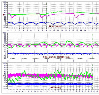

The project has been a great success! I now monitor both my refrigerator and freezer temps as well as the outside temp, and post them on my PH web site, along with auto email alerts if a temp gets out of spec.
I used the Maxim 1-Wire sensors and constructed a micro-LAN of 2-pair phone wire terminating in RJ-14 wall jacks.
The Maxim 1-wire sensors easily interfaced to Maxim's USB dongle and are supported by a free app from Mr Soft (www.mrsoft.fi) that yields nice charting. I ues the daily, weekly, and monthly charts.
