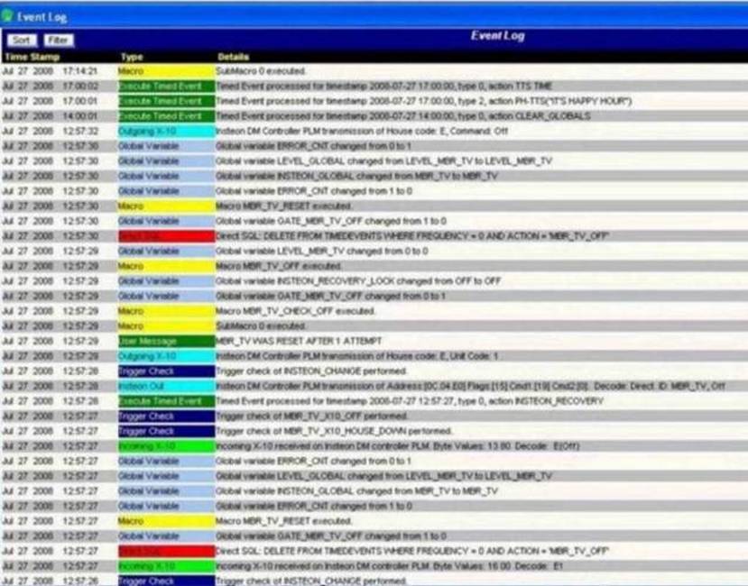

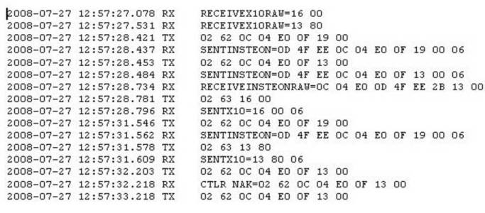

This is the same problem Tony is having with the PLM Lockup. I knew if I waited long enough and had the right traces running I might be able to trap this. In my case it appears to happen when an Insteon Appliance Module is having commands sent to it in both X10 and Insteon relatively at the same time. In the following trace you’ll notice at 12:57:28.796 an X10 address E1 is sent. At 12:57:31.546 there is an Insteon Status Request to the same device. At 12:57:31.578 the X10 command Off is sent. After that it nothing but a continuous loops of Insteon Offs and CTLR NAKs.
It looks like the Status Request was never responded to and an X10 command was sent after thus resulting in an apparent hang/lockup.. I guess my question is why isn’t PH seeing these continuous NAKs and terminating the loop? The cause could be the Appliance Module or firmware in the PLM or both.

Ah ha! An X10 command then BAM! Exactly what I am seeing.
Good catch. Hopefully, Dave can get something from this info.
