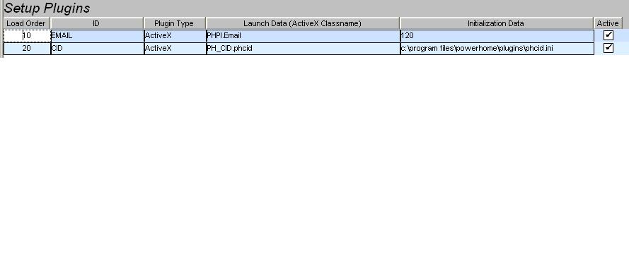

From the screenshot in the first post, it appears that PowerHome wasnt able to load the plugin at all. The very first line shows a 0 and the SDK version and plugin version are both 0. With these values as they are, PowerHome has not been able to initialize or communicate with the plugin at all.
Now, why is this happening? A couple of things to check. In the plugins screen where you've given the plugin an ID of EMAIL, make sure that your "Launch Data" is set to: PHPI.Email
For initialization data, you should have a number representing the number of seconds to automatically check for new email. If you want to manually check, then put a 0 in this field. Main thing is to not leave it blank.
Any changes made to the plugins screen will require a reinit to take effect.
It is, as shown in thie screen shot:
As shown above, it is currently at 120 Ihad changed it to 10 for testing but have since put it back.

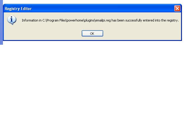

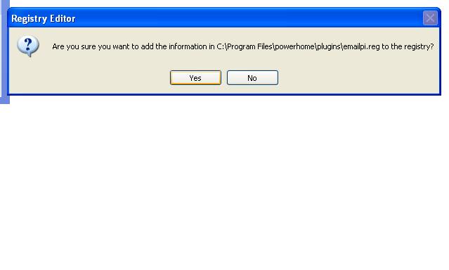

With the plugin data properly setup, make sure that the email plugin is properly registered. It's an activex control, but you cant use the regsvr32 command to register and must instead merge the registry entries contained in the emailpi.reg file (located in the plugins directory). You may need to edit this file down towards the end and set the directory to the proper location of the file.
See these two screen shots to confirm registration. I did the "merge" thing. Also, have triple checked the path to the .reg file, it is correct and has not changed since this was all working.
