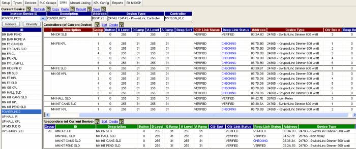

By the screen shot below, does it look like I missed something, I've deleted and recreated, and I still can't control the group? Thanks... Dave

Can anyone tell me if it "looks" correct, and if I should be able to control it from the PLC Group Dialogue box?

It looks correct, though I'm not sure why it says checking -- maybe you just hit verify or something? At any rate, can you control the devices independently? Post the SDM log when you hit the button, and see if the commands are getting sent out...

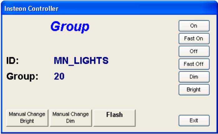

Below is what I get when I click the "Fast On" button for the Insteon Controller Group. Any thoughts?
ui:!sendinsteonraw=00 00 00 00 00 14 CF 12 00
uifinished:!sendinsteonraw=00 00 00 00 00 14 CF 12 00
si:00 00 00 00 00 14 CF 12 00
PLC:sendinsteonraw=True
PLC:eventraw=03
PLC:eventraw=03
PLC:eventraw=03

The only thing I can add is a "03" is a "Packet: Non-unique message received" whatever that means...

Your screenshot looks fine. The SDM log looks fine as well. The problem appears to be possibly communication issues.
You say that the Responders for the PLC now say "Link not Found". That would definately indicate a problem and the group control will definately not work if the links dont' exist in the responders.
When creating links, they will first be "FLAGGED CREATE". PowerHome will try to program these links and as long as the device doesnt become flagged as Comm failed and it appears that the communications went through successfully, PowerHome will then change the link status to "VERIFIED". However, the database flag in the device will have been updated and PowerHome will eventually discover this and flag the device for scanning. PowerHome will then read in the entire devices database and actually verify the links. If the links are not found, then the link will be changed to "LINK NOT FOUND".
Once you can get the links in the device and have them verified, then you should be ready to go. However, group command are broadcast and are not acknowledged. As such, they are much less reliable than direct commands. If you have any communication problems, the group broadcasts may not be heard.
I would look into why the links have changed to "LINK NOT FOUND". Are they really not there or is the PLC having a problem communicating.
