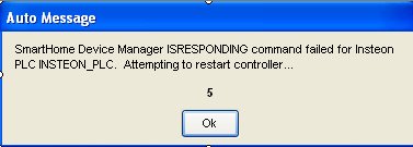

No ODBC dialogue, it starts right up, but the SDM for insteon fails to start, it keeps trying and if I open it while its trying, the log says the timer download failed?

SDM communication failures are most likely the result of the SDM not being set to the proper port for your PLC. The easiest way to troubleshoot and fix this is to temporarily take PowerHome out of the equation.
Shut PowerHome and the SDM down. Manually launch the SDM by navigating to the SDM directory default located in c:\program files\powerhome\smarthome\device manager with Windows Explorer and double-click SDM3.exe to start it. The SDM will start minimized in your system tray (the little "T" shaped icon) and you'll need to double-click it to bring it to the foreground. Click anywhere within the log window to give it focus and type D M. An editable field should appear below the log window. In this field, type: port=USB4 if your PLC is a USB device or type: port=COM1 (or whatever your actual COM port is) if your PLC is a serial PLC and press enter. You may get an error and the SDM may actually crash but it should have set the port. Test it by relaunching the SDM. Once you've got proper communication with the SDM and the PLC, you can shut the SDM down and restart PowerHome.
Also, don't worry about the 30 day trial. If it runs out and you need more time, just email me and I'll send you an extension key.

When I start Houselinc Desktop and look at system status it says
- PLC Software is not Valid, Please update PLC Core App
I updated the core app through the Powerhome Insteon Explorer, it completed, but I still have the exact same problem with timeractivate not enabled, and Powerhome saying Smarthome Device Manager ISRESPONDING command failed attempting to restart...
SDM still doesn't work on it's own, nor in Houslinc anymore.

I think I'm ok.
I did a hard reset of the PLC, and Power-home has control of it again.
Thanks for everyones help,
