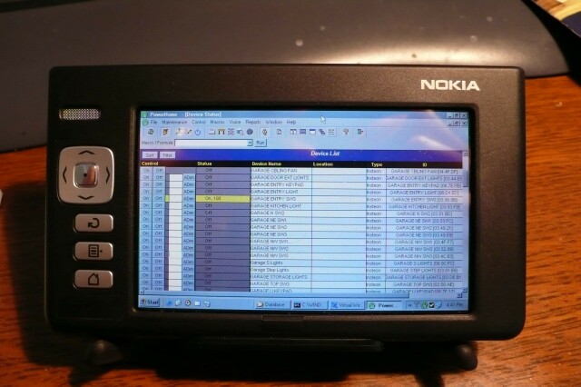

 I received my Nokia 770 today.  After a bit of a struggle getting it to connect to my Wi-Fi (I hid my SSID and use WPA-PSK, which the Nokia supports, but for some reason I had issues), I was up and running.
 If you're unfamiliar with the Nokia 770, it is essentially a  hand-held web browser with built-in Bluetooth and Wi-Fi networking.  My main reason for buying this was to use it with the control center through the web interface... I figured it was a cheap way to buy a touch-screen controller.  So far, it seems to work very well for doing that.  Not sure what the battery life will be, but it seems to be able to do hours without needing a recharge.

          Over on www.cocoontech.com (which looks to be down right now), people seem to be using this to run RDP connecting to another machine that has a GUI (i.e. MainLobby) and is reported to work well.

 Ajax sort of works. The browser is Opera (8 I think) and my pages don't play very nicely. I'm guessing that it will be possible to get 100% functionality eventually. Not a huge issue as I'll have to completely redesign as I'm going from 640x480 on a roughly 6"x5" screen to 800x480 on a roughly 4"x2.5" screen - everything is way to small for touch control!
 The screen is beautiful though. Wall mounting should be easy using the slip off cover that comes with the 770. You'll need to add some kind of wire cover on the bottom to hide the standard barel plug that powers it. Nice thing about this set up would be that you can have it look nice installed on the wall - yet it will still easily slip out to use comfortably from the couch.
 Also you'll need to do some tweaks to keep the screen from going to sleep (longest built in delay is 1hour) - see this article.
 This device is running Linux (Debian) so should be infinitely hackable.
 I've had minimal time to play with it, but so far it looks very promising. Worst case is I'll install PlayerPal and use it as a full function two way remote for wmp...
 I look forward to seeing what others do with it.

          So I am having no issues with my ajax stuff - it works great! The 770 is slow to run apps, but my intention is to leave it in full screen browser mode and it seems pretty snappy for that.
           | Posted: July 21 2007 at 15:51 | IP Logged |   |
 You can have the 770 boot off the memory card which is supposed to massively speed things up. I've ordered a card...

 I used the above link to set my timeout to infinite (0 seconds) while plugged in. The screen still goes off, but touching the screen instantly brings it back - I think good enough for me.
 I tried the minimo browser (same code base as firefox), but was disapointed. It will run full screen though.

 I'm having some stability issues. When I leave the device running opera with my control page it seems to reboot after a couple hours. Which means I loose my internet connection and the control page. I'm not running with the most current image - I'm just using the OS that came loaded. So perhaps that will help. I'm also intending to boot off the memory card.
 I haven't had a lot of time to experiment, but today I left minimo running my control screens - I'll be curious to see if that runs more stable. I don't like minimo as much - I've not figured out a way to get rid of all the displayed controls (i.e kiosk mode), and the screen flashes everytime I load new data (like fire fox).
 Worst case is that I'll get my page to automatically be loaded in opera on start up - that should make it mostly usable. Maybe slowing down the data refresh rate (~3 seconds right now) would also make it stay up longer.

       | The NetRemote screen shots look great and I wish there was a way of running that on the 770 but I doubt that will ever get ported to Linux. |  |  |  A round-about way to do this is running Remote Desktop. I have seen RD for the 770 somewhere.

          Thanks TonyNo, rdesktop is pretty slick.
           | Posted: August 12 2007 at 20:09 | IP Logged |   |
 I thought this would be an easy solution till I remembered that I will have multiple 770s throughout the house.  I am going to try an experiment running vmware with multiple xp virtual machines running netremote.  If that is tolerable, this might be the solution, be it a very messy and complicated one.
