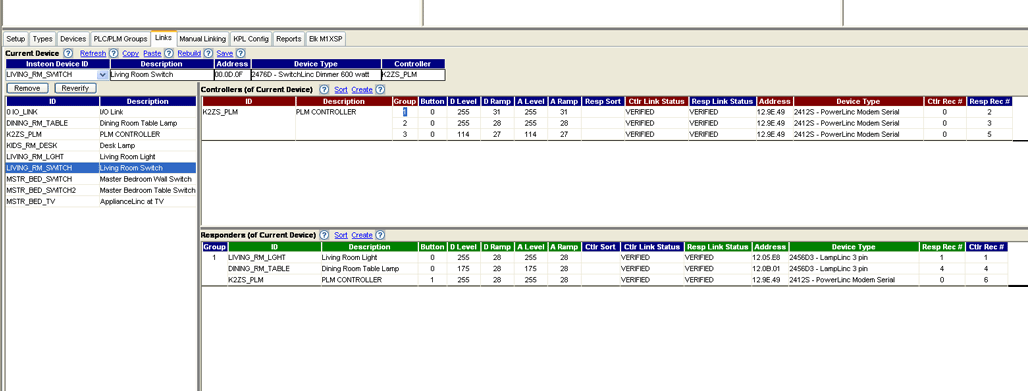

I have started to add some switches to my network, previously all I had was lamlinc modules that I controlled through macros and programming. I have replaced 2 switches with SwitchLinc 2476d's and have all my linking done. One controls a local load and one controls a lamplinc in an outlet. For some reason I don't see the status change in the device status window when the switches are controlled locally. I have the plm as controller and responder based on group ID, some have multiple group entries.
When I found the status wasn't updating I tried various combinations of linking but no luck. What am I doing wrong?

The SwitchLinc requires a link as a controller to the PLM as a responder for PH to see an On/Off change with a paddle press. If those links are in place post the Links tab for one of the switches and the Insteon Raw Log when you press the paddle.

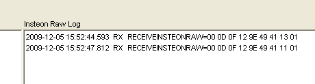

Thanks Lee, I hope the image is usable. When you press the off paddle insteon raw data is :
The top row was on, the bottom row was off.

There is a difference in the PLM responder link on my system. The responder green Button column is 0, yours is showing button 1. Try changing that value to 0.
Also there is no Group Broadcast message in your Insteon Raw Log trace. That suggests the powerline is not as good as it could be. The Group Broadcast message is not retried so it appears on the powerline only once for each paddle press.
2009-12-05 16:19:29.720 RX &nbs p; RECEIVEINSTEONRAW=04 56 50 00 00 01 CB 11 00
2009-12-05 16:19:30.252 RX &nbs p; RECEIVEINSTEONRAW=04 56 50 0F 44 DC 41 11 01
2009-12-05 16:19:32.533 RX &nbs p; RECEIVEINSTEONRAW=04 56 50 00 00 01 CB 13 00
2009-12-05 16:19:33.048 RX &nbs p; RECEIVEINSTEONRAW=04 56 50 0F 44 DC 41 13 01
I checked my Device Status display and it does change when I press the paddle on my ICON switch. Does not matter the device type in this situation.

PowerHome will only allow the button assignments as shown in the image, if I try changing it I get a pop-up alert message telling me so.

| Posted: December 05 2009 at 17:15 | IP Logged
Don't know how I got my entry to specify button 0 as when I changed it to 1 and Saved it would not let me change it back to 0.
Only other thing I can think of is to use the Insteon Explorer Setup tab, Clear the PLM, then do a PLM Add Full to rebuild the PLM.

k2zs Senior Member
Joined: October 22 2009 Location: United States
Online Status: Offline Posts: 113
| Posted: December 05 2009 at 17:25 | IP Logged
That did the trick, Thanks Lee
