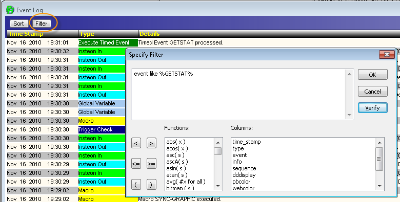

Dave - that sounds so straight forward but when I tried as illustrated below, I get an "Expression is not valid" error.
There is no "EVENT" choice in the Functions or Columns panes of the Specify Filter window, so I assumed one just entered an SQL like formula directly.
What am I missing?
| Posted: November 16 2010 at 20:04 | IP Logged
Ken,
event is in the columns listbox, 3rd one down .
Your problem is that you're missing the quotes around %GETSTAT%. It should look like:
event like '%GETSTAT%'
