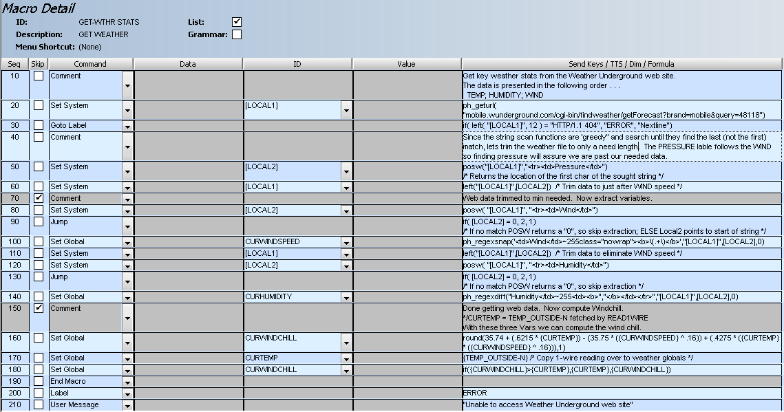

Tony - thanks to all your insight and help I now have a terrific addition to my home automation arsonal!
Since this thread seems to have a number of efforts that struggled to get this going I thought it might be useful to post my working effort as of 11/18/10 (reflecting the current state of the WeatherUnderground web site).
Since I was only interested in getting the windspeed and humidity (I already have an outside temp probe) and computing the windchill factor, my approach is simplier than your more general effort, but since this provides some current functionality with the web site, I thought it might be useful to others, and provide some further examples.
Also I "enhanced" things a bit since the ph_regexsnap() function is "greedy" in that it does not search for the first, but rather the last string match it can find, I thought it might use less PH compute time to Trim the weather data string to the minimum length as searches were done.
Thus I started by looking for the last data element first (nearest the end of the data file) and then worked toward the beginning, trimming the file length as I went along.

In a more human readable form, this looks like . . .
To correlate the code with the target web page, here is a snapshot of the weather page . . .
And here is the HTML Source Code for that image . . .
Hopefully this might help others trying to do something similar.
