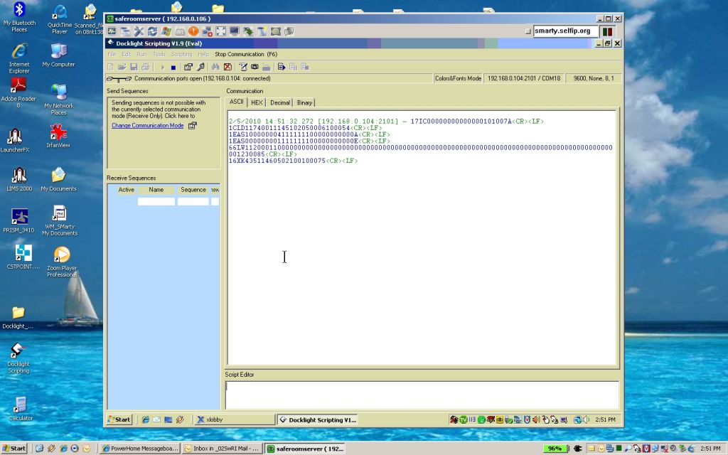

OK, I think I connected DockLight up to the Elk properly (set Docklight to receieve only, pointed it at 192.168.0.104:2101 <=my elk).
Here is what I saw when I did a "Dis-Arm":

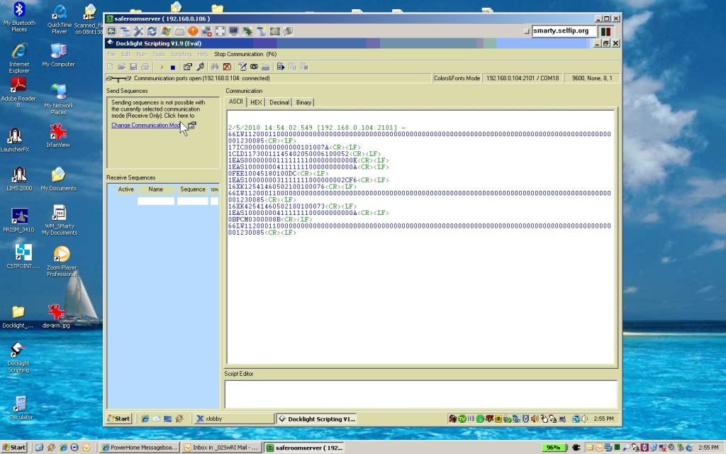

And, here is what I saw when I did and "Arm-Away". I let the screen record until the countdown timer expired.

If I did the interpretation correctly it looks like 4 Arming Status Report (AS) messages were generated for "Arm-Away".
1 – Dis Armed - Ready to Arm
2 - Armed Away - Armed Fully
3 - Armed Away - Armed with Exit Timer Working
4 - Armed Away - Armed Fully
EDIT: they look like they track to the 4 triggers that were fired. First ELK-DISARMED trigger, followed by 3 ELK-ARMED AWAY triggers.
Is that what you found.
