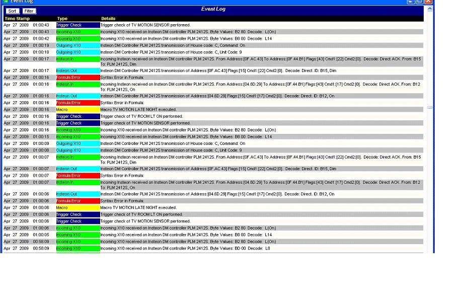

The event log just says DIM and CMD1 of 22 every time. The raw log is below.
2009-04-27 01:00:17.015 RX &nbs p; SENTINSTEON=0F 44 B1 0F AC 43 0F 16 00 06
2009-04-27 01:00:17.328 RX &nbs p; RECEIVEINSTEONRAW=0F AC 43 0F 44 B1 2B 16 00
OF.44.B1 is the PLM and 0F.AC.43 is the device which says it is turning on dim, but is not actually turning on at all. In fact, a third light appears to dim, and there is no record of that in any log!

OK, to make sure I understand this right, you send a Direct Command to 0F.AC.43 and it ACKs but 0F.AC.43 in actuality does NOT turn on but another light does. Whats its address?
Posted: April 27 2009 at 18:57 | IP Logged
A 0x16 (dec 22) Dim command does not tell a device to turn On Dim. It tells the device to drop down one level of intensity from its current level. If it was at intensity 21, it would drop to intensity level 20. If it is Off to begin with it remains Off. The command will be ACKed because the command was addressed to a valid device, was a valid command, and it was acted upon.
EDIT: can you post the Raw Log that shows the complete sequence for both the Relay device and the Dimmer. Several commands (in other words several seconds) on both sides of the sequence. The dimmer device that was Off would not visibly respond to a Dim but I assume you sent an ON to the Relay device and it should have reacted. The fact that the results are reproducible suggests there is another factor involved not yet understood.

OK, I'll post all the logs. I was a little pressed to get the kids at school on the last post. In the interest of full disclosure there are actually two things that happen when the motion sensor fires. One trigger turns on an X10 light (a wall wart RR501). This always comes on when it is supposed to. The other trigger fires the aforementioned macro. My bad on the DIM. I assumed it would be set to a "dim" level, not what Lee mentioned. Problem solved there since it would have been off anyway. The other issue is the relay not turning on the fluorescent lights. The third issue is the pantry light coming on when it is not supposed to. I just tested and it turns out the pantry light IS coming on (at a dim setting) with the X10 (C9 ON) command. I will try and remove the X10 setting from this device for a second time. Hopefully another reset will stop this errant behavior (why doesn't it show as an X10 device in PH?) As for the relay . . . here are the logs:

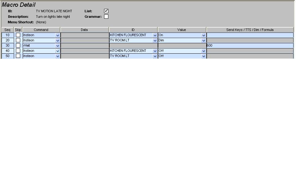

Here is the event log and copy of macro

Wow. As for that Icon dimmer (pantry Light) that comes on with a C9 ON command, it turns out I actually have two Icons switches that are coming on (dimmed, 44 and dimmed, 47). The manual reset did nothing, and rebuilding the links in PH hasen't fixed this problem. Bit of a sticky wicket . . .
Posted: April 27 2009 at 20:53 | IP Logged
The ON command 0x11 (dec 17) to 04.6D.29 looks okay. The command was issued and the device ACKed the command. This sounds like a reproducible problem from your earlier post. Since the command itself is okay, then it could be the switch itself, the load it is controlling, or some other command (Insteon or X10) is having some interaction with the switch.
I would start a process of elimination. Check the Skip column for everything except the ON command itself, including the X10 C9 ON that is being issued from somewhere else. Be sure to Save (PF5) after making the changes. If the basic ON command works then add back individual items one at a time until it stops working. If the basic ON command does not work then you are looking at the switch itself or the type of load it is controlling.

I checked SKIP for all but the ON command. The macro fired and the light acked, but it didn't turn on. I am baffled. I will rewrite the command using just a raw command with an trigger and see if that fixes it. I really don't like the way I always get a FORMULA ERROR when this macro is sent.

I'm checking with some actual tests but that Direct command to 04.6D.29 is wrong. A Direct command should have the bright level in cmd2. A bright level of 00 is unusual and will probably result in the equivalent to an OFF. Normally it would be 11 FF. I'll update this post in a few minutes.
EDIT: A Direct command 0x11 (dec 17) with a cmd2 value of 00 has the effect of turning the device Off. cmd2 has the bright level normally running from 1 - 255 decimal. With a Bright level of 00, the device is Off.

Posted: April 27 2009 at 21:49 | IP Logged
That works. I don't know why the macro doesn't work and the plain old trigger with a raw command does work, but I can work around it a this point.

Posted: April 27 2009 at 21:56 | IP Logged
Put a value of 255 in the Send Keys field of the Insteon On macro line. That will put 0Xff into cmd2 and the device will turn on.

Posted: April 27 2009 at 22:00 | IP Logged
Genius! That did it! I had nothing in the SEND KEYS because I didn't know any better. I assumed "ON" would just set it on at 100%.
Posted: April 27 2009 at 22:06 | IP Logged
A Direct On command can set the device to any desired Bright level, from 255 (0xff) which is full on to anything down to 1. At 1 the bulb filament may not be bright enough to actually see.
Even though this is a relay device it must still make a differentiation between some positive Bright value and 0x00 being Off.
