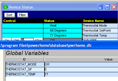

Posted: July 25 2008 at 21:59 | IP Logged
OK!
Got all SQL imports to work OK and can now control my THERMOSTAT but I cannot get any status from it!
I made sure all of the Global Variables match in name and everything looks OK in the AnalogIO definition, and the macros but my "Device Status" window in PH never changes from Heat Mode, 68d Setpoint, and 71d Temp. Even after running the 'TSTAT_GETTSTAT_GLOBAL' macro, the Device Status never changes.
As the attached screen capture shows, the Global Variables are correct (except for the setpoint) but the Device Status is stuck at some static value.
I've refreshed the window (F5) and re-initialized and even restarted but the Device Status never changes from the above noted, which do NOT match the Thermostat actual values at all.
Ideas?

Posted: July 26 2008 at 07:39 | IP Logged
martlist -
Thanks. I have tried all of the various posts without success, but that said I may well have not cleanly purged the db between efforts. My current config should be clean, but looking back I'm not sure which source it came from. I think your last post, but the easiest way to advise correctly is to send you screen caps and my SQL insert work sheet. Rather than clutter up the Forum with all that, if you send me a Private Message with your email address, I will forward everything directly to you.
Posted: July 26 2008 at 07:47 | IP Logged
Woops - I forgot to add to the above, that I do have Virtual Devices as I wanted the STAT settings to show up in the Device Status window.
I modified the Virtual Device variables to match the Global Variable names so that (I thought) TSTAT_GET_GLOBAL would update things correctly.
Maybe seeing my SQL Insert worksheet will answer the questions.2008-07-26_074645_STATmacros.txt
Posted: July 26 2008 at 08:49 | IP Logged
martlist -
Your comments insppired me to throw everything out and try again, using Dave's original post and the Virtual Device method.
BUT still the same (non) result The Device Status window only reflects the original Analog IO "insert into analogio values" settings.
Here is the complete script I copied and pasted into PH's SQL Script Editor.
Do you see anythng wrong with it?

Posted: July 26 2008 at 11:32 | IP Logged
GOT IT!
Just proves that if you stick at something long enough, you'll either die or solve it. Fortunately the latter was true this time!
The problem was with the GETSTAT macro. The Forum (%$#@!*^) word wrapped a command and stuck a space in the middle of it, making it non-functional.
As shown above, I've corrected the first one, which initially was clobbered as the 2nd and 3rd lines are! A "ph_in steonwithret()" function just doesn't work!!!
I now have a fullyl functional (read/write) STAT (except I can't turn it's Mode to OFF). There are times when I don't want it in Heat or Cool mode, but just plain OFF. Tried modifying SETSTAT macro by adding a "when "OFF" then 0" entry to line 40, but it didn't work.
