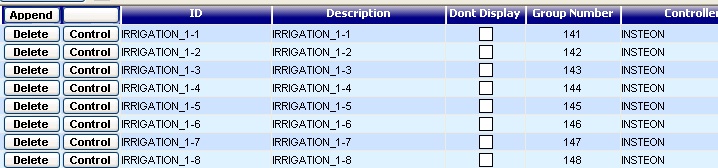

I changed the Mem Top column setting and also the other things you mentioned, but no luck. I still can't get the valve to flip when I try to control it by the group. I've reinitialized after making the changes also.
Here's what my groups, links, and type screens look like:
One odd thing is that when I switched the DLevel and DRamp to 0 I could turn on the group, but I couldn't turn it off in device status. It would stay stuck in the ON position despite chaning it to off, and wouldn't flip back until I changed the DLevel and DRamp back to the original settings of 255 and 31.
Thanks.

Posted: April 09 2011 at 22:54 | IP Logged
You did Reinit after setting the Mem Top?
The D Level etc changes were made after the Reinit?
What does the Insteon Raw Log show when one of the PLM/PLC Groups is turned On?

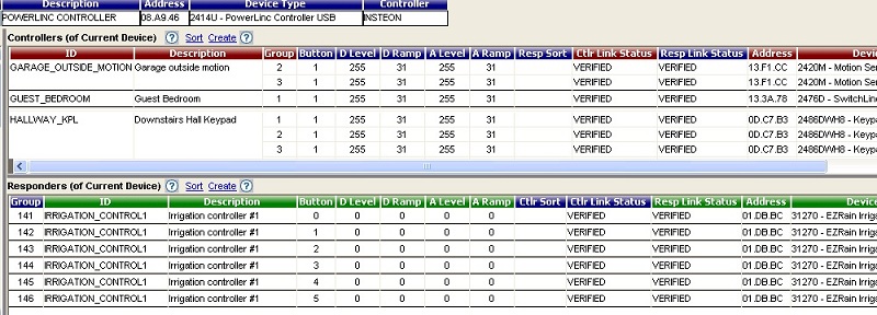

It still doesn't appear to be working. When I try to turn the group on and off from the groups tab the valve doesn't do anything.
Here's what I've done:
-Checkmarked the ALDB option on the device.
-Changed the top mem column for the device on the types tab to 16384.
-Deleted and recreated the groups on the groups tab.
-Deleted, saved, and then readded, saved the groups on my PLC.
-Reinitailzed PH after making the ALDB and mem column updates.
-Ran Rebuild on the EzFlora device.
Here is the raw log file from when from the group I try to do an ON, FASTON, and then an OFF.

Here's a screen shot of what the group entrieds look like under the responders section for my PLC.
Group 141 is zone 1, group 142 is zone 2.

Posted: April 10 2011 at 19:12 | IP Logged
Turns out the link records cannot be written in the EZFlora with your configuration. I think you indicated in an earlier post the PH2 controller is a PLC but that point did not register until looking at the Insteon Raw Log messages. A PLC does not support Extended commands. The extended ALDB command is the only command that can be used to read/write link records in an EZFlora. This has been true since EZFlora firmware level v26. The latest EZFlora firmware is v28.
Sorry it has taken me so long to put all the pieces together. I switched to a PLM so long ago that PLC limitations do not come to mind anymore.
You can control the zones manually using the same commands in the Macro gotten from the forum. The commands used by that Macro are SD (standard) messages so they will work with the PLC and they do not require or use link records in either the PLC or EZFlora. The PLC/PLM Group definitions will work if you ever update to a PLM so I would not deleted them. More and more Insteon functions/features are being configured with Extended commands. Motion Sensors and TriggerLincs are the same way. Only the Extended ALDB command can be used to read/write link records in these devices. This may also be true for the new SynchroLinc but not absolutely sure about that until mine arrives. Eventually so many things will be blocked by a PLC they will become history.
Again, sorry it has taken so long to realize that it will not work.
