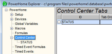

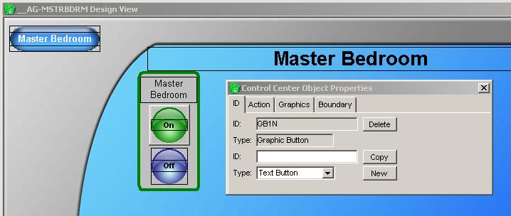

Posted: January 18 2009 at 20:59 | IP Logged
I'm having trouble figuring out what the values are for the CC_TAB_ID_OF_BUTTON and CC_BUTTON_ID_OF_LIGHT? Are these found in the design view of the control center?
This is the error log:
Syntax Error in Formula: ph_setccobjbcolor(~"GB1N~",~"MBLIGHT~",case( when 0 then 8421504 else 65535))
Thanks
Edited by williammanda - January 18 2009 at 21:46
Posted: January 19 2009 at 07:50 | IP Logged
The CC_TAB_ID_OF_BUTTON is a string which the name of the Tab (presentation page if you will) on which your buttons lie. If you just have a single Tab (which is probably your case at the moment) and you used the Wizzard to create your CC screen, then that Tab will have been auto named to be the same as the Location (up/down/in/out/kitchen/etc) that you gave for the Insteon Device in its Unit definition. You can also see the name by displaying the Control Center in Insteon Explorer.
Here is mine, where I have renamed my Tab to be "STATUS".
In this view you can also change the Tab name by clicking on the name shown in the ID column and changing it to what you want.
The CC_BUTTON_ID_OF_LIGHT is just what you have named the CC button that controls your light. In your case it is "GB1N"
Thus putting it all together, but using my Tab name since I don't know yours. Your change object color command would be
ph_setccobjbcolor("STATUS","GB1N",case(when 0 then 8421504 else 65535)) |
